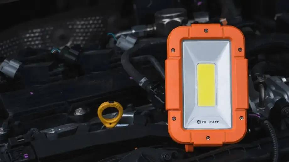

Application scenarios of COB lights
Since COB lights have so many advantages, what can COB lights be used for?
COB LEDs are widely used in our lives as high-efficiency light sources. For example, COB LED light strips can be used as decorative lighting for outdoor camping and living scenes; COB LED spotlights are mainly used in hotels, exhibition halls, and living rooms as small fill lights to create a warm atmosphere. High-power COB LED bulbs are used in scenes with high brightness requirements, such as: football stadiums and large industrial scenes. In addition, handheld devices with COB LED technology can also be used as flashlights.
