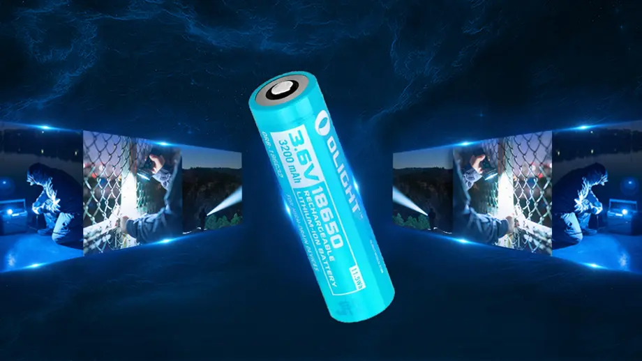

We all know that to use a powerful flashlight and realize its full potential, it must be powered by a high-capacity, high-performance battery. Currently, rechargeable lithium batteries are used in the field of mobile electronic devices, such as smartphones, laptops, drones, and Olight flashlights.

To sum up, lithium-ion batteries do not need to be exhausted before recharging. Since most Olite flashlights use lithium-ion rechargeable batteries as their energy source, there is no battery memory effect. Users can charge immediately, and there is a protective circuit board inside the Olight battery, which can effectively avoid overcharging, over-discharging and short circuit. , high temperature and other problems, it can well protect the safety of users.
