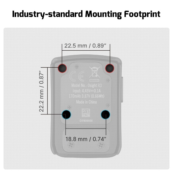

Your Osight optic utilizes the industry-standard mounting footprint (seen in the picture below) which is the most common footprint on the market today.

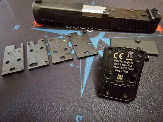

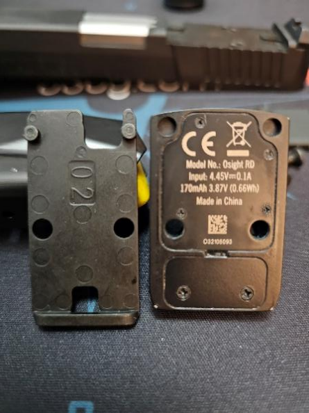

Step 1: Choosing a Compatible Mounting Plate
Selecting a mounting plate that matches your slide cut or rear sight dovetail is crucial. This is essential for a reliable and sturdy connection of the red dot sight.
If your mounting plate requires additional screws to attach the mounting plate to the slide continue to follow the instructions.
If your mounting plate just rests between your slide and your Osight without the need to screw down the adapter plate you may continue to step 3.
If you’re utilizing a factory red-dot-ready firearm, you may have to remove the pre-installed “blank” plate before putting in the mounting plate.

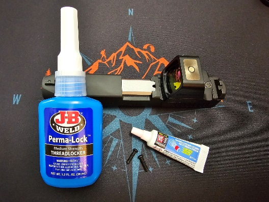

To ensure a secure installation, applying a small amount of Blue Loctite or a similar thread sealant like Vibra-Tite VC-3 onto your mounting screws is recommended before proceeding. This will prevent them from becoming loose over time due to recoil and vibrations.

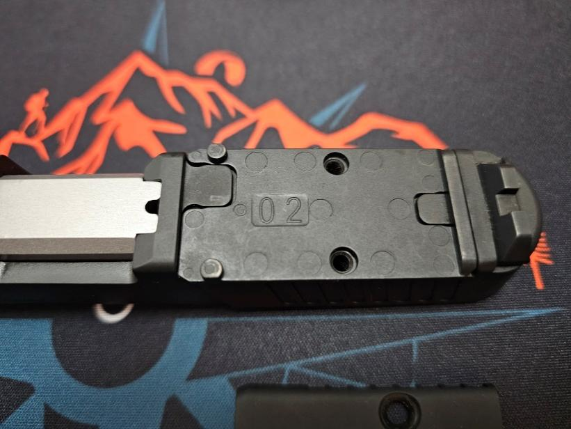

Ensure the plate aligns perfectly with the slide cut or rear sight dovetail.

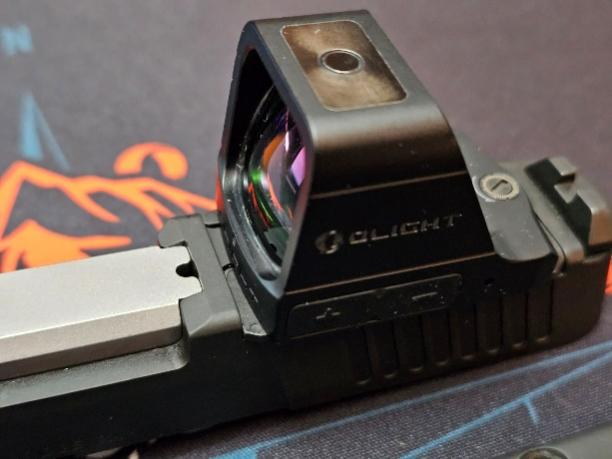

If your mounting plate uses additional screws to attach the plate to the slide use caution when driving the mounting screws into the plate, ensuring they fit snugly but avoiding overtightening. In my case, the mounting plate rests directly on the slide and utilizes the screws that attach the optic to slide.
Step 4: Mounting the Red Dot Sight using a mounting plate
To mount your red dot sight properly:
Ensure your OSIGHT lines up with the screw holes on the mounting plate.
Utilize the screws that came with the OSIGHT or use the screws that the firearm manufacture provided.

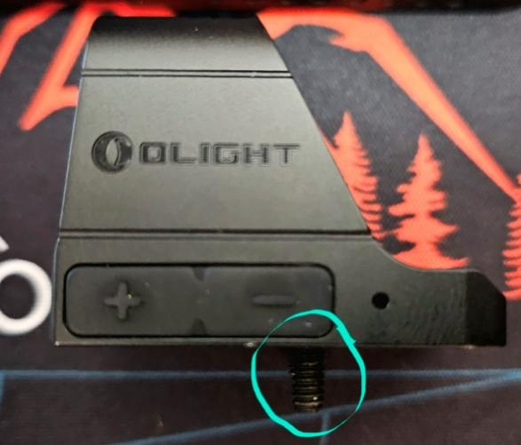

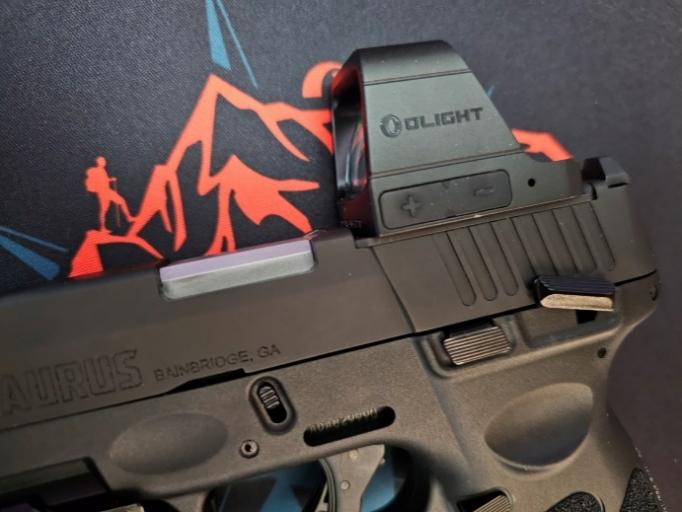

Make sure the screws protrude far enough but not too long from the bottom of the optic to fully engage the threads on your slide with the mounting plate. In my case I used the screws that Taurus provided since they were longer.
Apply Blue Loctite or a similar thread sealant to the screws before tightening them to achieve a secure fit.

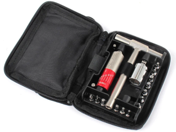

Avoid over-tightening the screws, which can harm the sight or mounting plate. Some firearm manufacturers specify the amount of torque to apply. In my case, Taurus indicated to use 8.2 in-lbs. of torque. I use a digital torque driver or my FIXIT STICKS toolkit which has a torque driver.
Olight recommends that 17 in-lbs. be used to mount the Osight but make sure to check the firearm manufactures recommended torque rating as well to avoid any damage to the optic, slide or the fasteners.
Once the screws have been installed with the proper thread locker put the firearm aside and let it sit for 12 hours to let the thread locker cure.

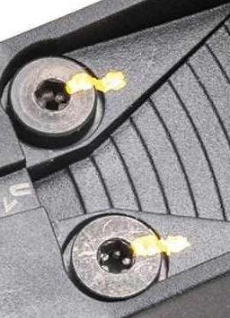

Once the screws are torqued to the proper in-lbs. I recommend that you mark the screw fasteners with a paint pen order to check at a quick glance for any movement that could result in a loose optic.
