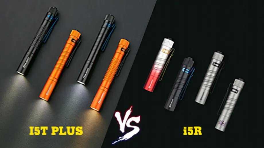

Greetings O-fans! In this edition of the Olight Canada Blog we will discuss the differences between Olight’s latest model, the i5T Plus, and it's smaller cousin, the i5R.
The i5R is a USB Type C rechargeable EDC light that replaced the original i5T in the Olight lineup. In contrast, the i5T Plus is an EDC working light that runs on a pair of readily accessible AA batteries. As closely related lights, these two models share some obvious similarities, but they also have some distinct differences. We will compare the lights against each other using three main categories: Form Factor, Performance, and Features.

The biggest difference in the form factor, aside from the size and weight which we will dive into shorty, is the customization options of the i5T Plus. It will continue to be available in four colors, including the always popular OD Green, and Olight's signature Light Orange. Both of which were limited edition colors of the i5R, and can now only be found on the secondary market.
Unlike the i5R, the i5T Plus offers you your choice of 3 LED color temperatures! Read my previous blog post for more information about that!
Also unique to the i5T Plus is your choice between the familiar helix knurling, and the brand new pebble knurling. In my testing I found pebble knurling shows superior performance in both gloved hands, and in tight spaces that require dexterous manipulation.
