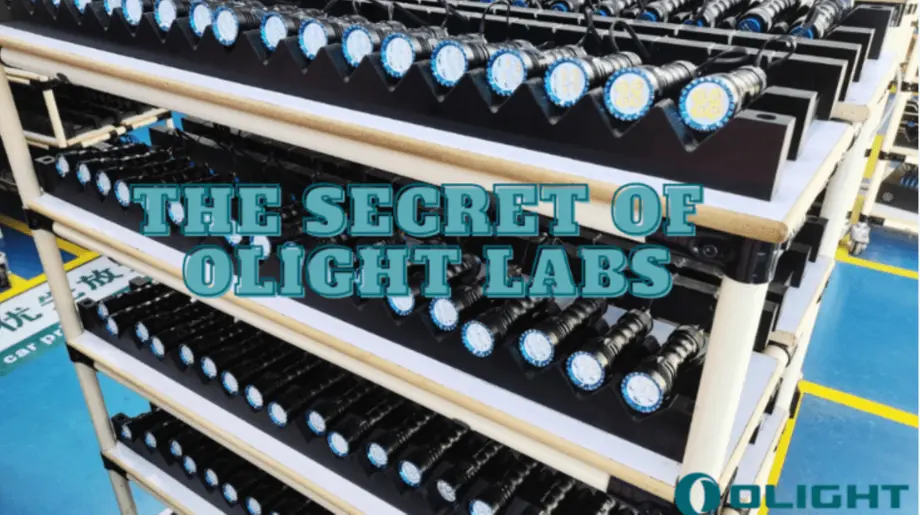

☞ Testing at the factory shipment stage
In order to get a satisfactory pass rate, OLIGHT flashlights are subjected to various sample-based reliability tests before leaving the factory, in addition to a very important test called the " secular variation test".
Item 5: Secular variation test
Electronic products have an indicator called product failure, which is similar to human illnesses and prone to various illnesses when young and old. Therefore, in order to avoid the early stages of multiple illnesses, the secular variation test is to reach the peak as soon as possible and confirm the illness.
OLIGHT flashlights are 100% charged and discharged aging tested prior to factory shipment. The charging and discharging aging process is as follows: full charge → charge check (check full charge voltage, charge indicator, charge time, whether the charging process is normal, etc.) → aging (discharge time according to the duration of the model) → discharge It is a check (checks whether the temperature, switch, dimming, discharge time, and discharge process are normal). (Temperature, switch ON / OFF, dimming, discharge time, whether the discharge process is normal, etc.) → Charge to the shipping voltage → Full inspection of appearance and function
Through the aging test, we check defective products and defective devices, select products with a high risk of failure or failure, confirm quality defects and hidden dangers of shipped products, and check initial defects of products before use. Eliminate as much as possible to ensure the quality of the shipped product. So you can believe that every flashlight you get is guaranteed in quality.
